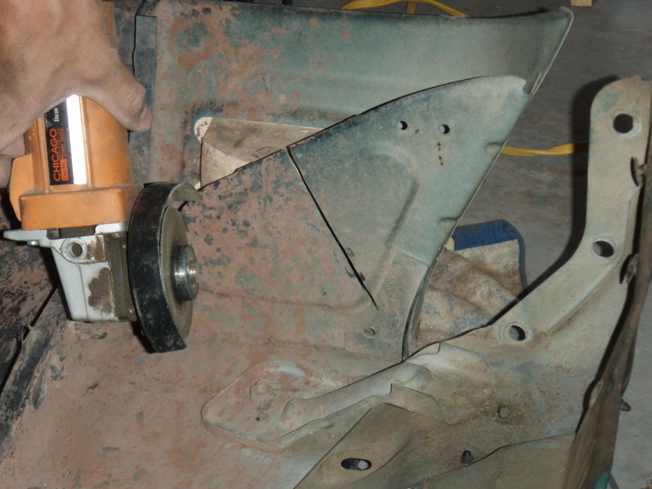

When ya get a chance, post the under fender mod support pics. thanks for the add

Do you mean the front support?
Really just a slice and dice thing. Make a cut in the middle all the way up until each side of your triangle no longer touch. I used a grinder as far as would go and then a dremmel to get further in for the rest
Niether Offroadaz or Yellowsub did anything to "fix" it although if not a simple tack weld, a bolt could actually meld the support sides back together once bent past each other.
Thanks, I'm guessing nothing was done to the other support.
Yes the other support was trimmed to to allow it to stay on the same fender mount but still move up on the tub.

i would really like to do this mod. when you guys bent the fenders to fit in the new spot, how did u bend them?
Once we had the support cut, and then all the bolts back in... drumroll... we stood on them. Just get some equal weight on the top of the fender and get to where you want it. It can take it.
skatchkins wrote:Once we had the support cut, and then all the bolts back in... drumroll... we stood on them. Just get some equal weight on the top of the fender and get to where you want it. It can take it.
hah yep, I was nervous at first, but they really did support allot of weight
